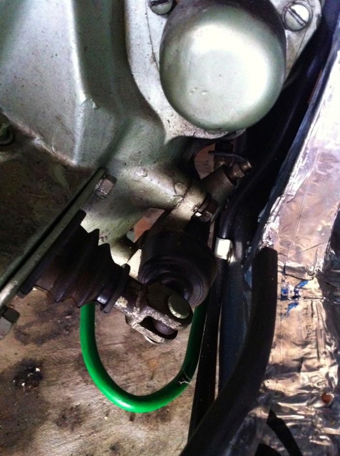

I've just replaced the dust boot on the clutch fork and noticed while doing it that one of the bolts securing the slave cylinder to the gearbox housing was loose. When I tightened it, I found why - its stripped.
I'm supposing the solution is a heli-coil, but this looks like a gearbox out option, as there is no room around the hole to repair it that way in place. Are there any other options?

Not a correct method, but one I used in an emergency, was to try a coarse thread bolt or a slightly larger (metric) bolt. My temporary solution was done in 1965 on my BN6 and worked without a problem. Use a tap if you can, so you don't crack the bell housing. Bob
healeyblue
How about try a longer bolt to see if there are any better threads further in? Check first with the bolt out and a bent piece of wire to see if it is a through hole or a bottomed hole, so you don't run into the bottom with the new bolt.

Thanks, those are both ideas that i'll try out. Either way I can then go on and re-tap with the g'box out if they don't work i guess.
