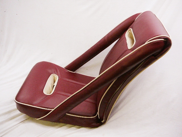

Well I've installed the new steering wheel and it looks great and has given me some more room. I am still investigating other methods and certainly changing the pivot up on the back, along with removing some foam sounds like the simplest so far. I've been emailing the manufacturer of the seat shown about a custom order to fit the interior color. I would get more room with these and still keep the original seats.
