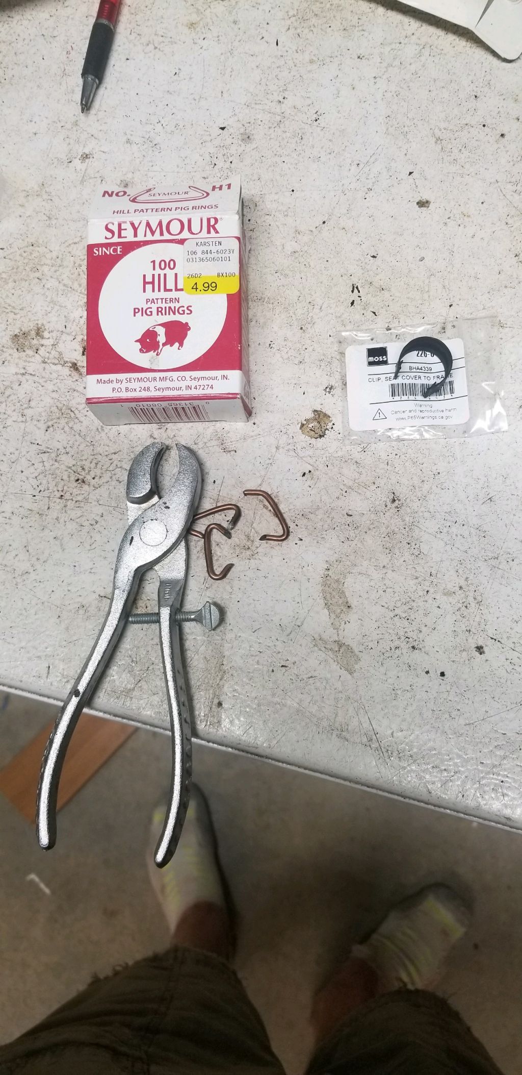

They are called Hog Rings and kits of rings and pliers are available at most hardware stores.

I got 24 of the "C" shaped rings. Now I have i=to get the seats back together.
The photo shows Hog rings and pliers on the left and "C" rings on the right.

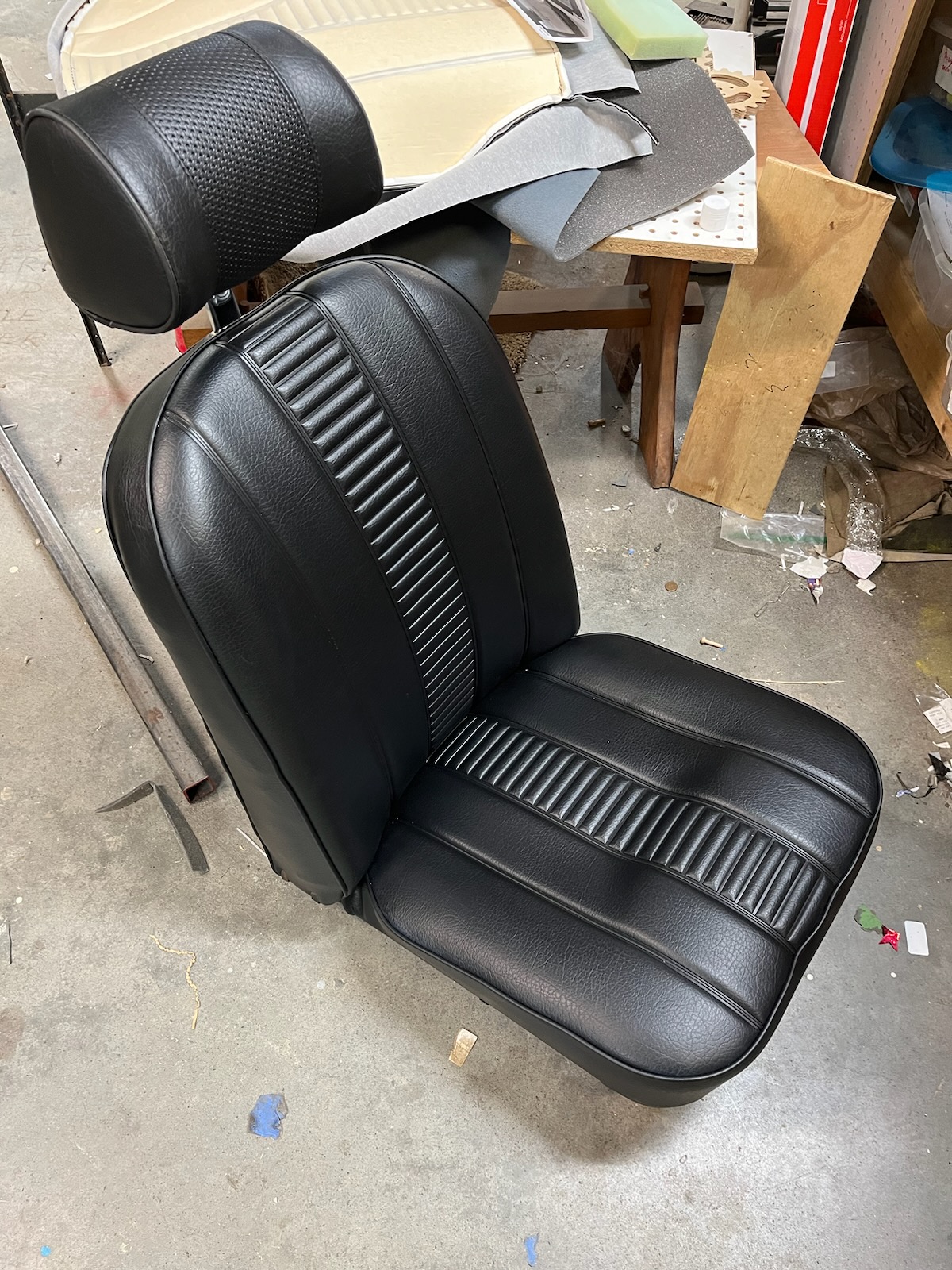

Got the second seat finished at last. It was more of a headache than the first because the seat back foam mold was offset by about 1 1/2". That is the depression for the seat frame was off center. Called Moss and they finally said some times the foam requires some trimming.
They both look good and I have the runners attached and the seats in plastic bags to protect them till I get them in the car.
