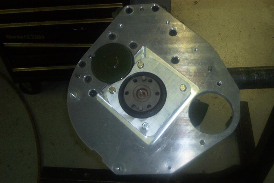

The instructions are quite involved, go to www.raysmg.com, Ray Mcaleb should have them. Here's a photo of the one I installed on his engine.
