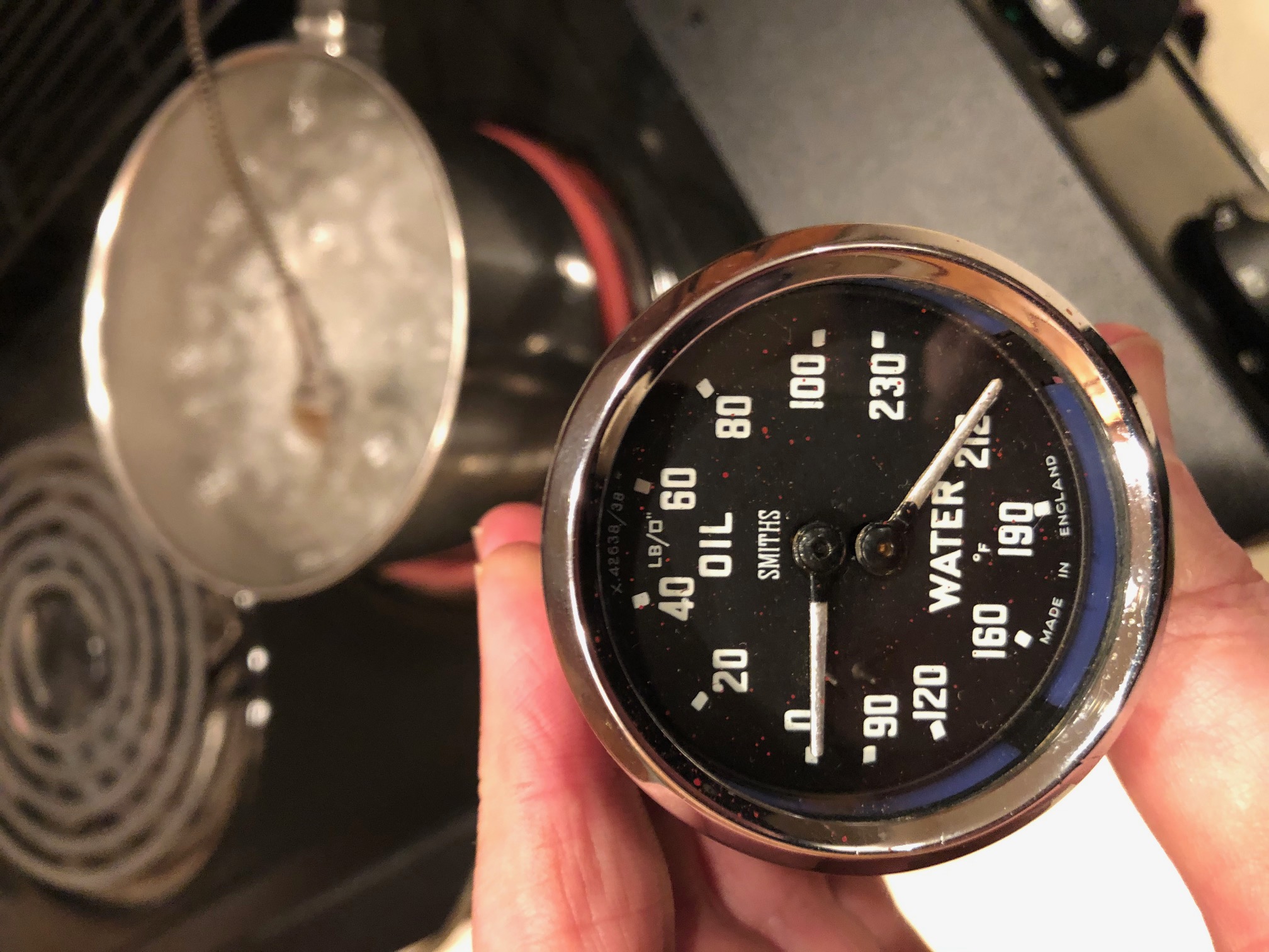

It's easy to test the temp. gauge - just pull the sender bulb out and put it in a pan of boiling water, should read 212F when the water boils.

Speaking of checking gauge accuracy, I couldn't resist posting this pic (of a gauge from a BN2!) once again:
