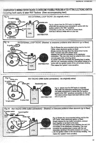

Now I'm trying to hook up a 123Ignition brand Distributer I like the one in my jag. it says hook up just the red to the coil only Check turn on ignition and twist till the LEDs are out. no LEDs .... bright sunlight doesn't help, sun sets not till 11:00. .... but thats not why I'm writing when i turn the ignition on the Tachometer hops up like .... well I will spare you the colourful medifore .. it hops to attention. why? there is only one way to wire the tach, the speacle connectors make sure of that. ..... oh could it be because i have an earlier dash and harness? I have tried plugging in the black wire from the new Distributer to the coil the tach still hops up. no i have not put anything to the crank position or even hooked up the coil yet.

toast ok the Distributer web site says that it won't work with RVI smiths Tachs.
dose that mean the car won't run or that i just have an non working Tach?
this might start to explain the issue with my midgets tach and the malory
but strange the Jag is smiths and it just dropped in no problem.
can i take the white wire that goes inane then out of the tach and just connect those two ends and bi pass the tach ?

ok im wire away from the car starting or smoking 250 bucks.
I'm doing the last diagram i have the blue wire in, but do i hook up the red or the black wire from the tach to the Distributer.
it looks like the diagram is from "enjoying mg" october 2012 any one have it in colour?
