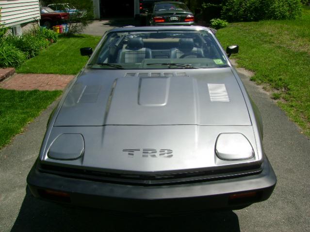

I have 2 TR8s that I'd be willing to sell, and I'm not that far away from you. One is fully restored, and one is undergoing a resto after I dragged it out of a garage in NJ this past Summer. It's been off the road since 95. Both are grey with blue and both have about 68K miles. They are going on Ebay in the Spring regardless. I'd love to help guide you along the path to TR8 ownership.
