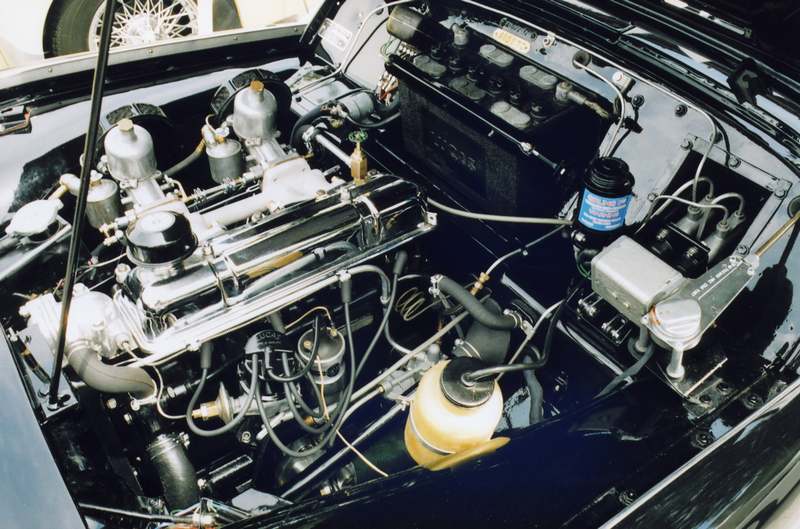

Oddly he only shows one photo of the engine (from the good side?) and none under the TR.

Good news is that there is now a shot of the underside. Bad news is that it shows a chassis that looks to have been rather casually cleaned up before a quick repaint. It also shows some inexpensive "cherry bomb-style" mufflers...and mismatched tires on the rear!
The one wheel shot clearly shows a 48-spoke wire wheel. I don't have a problem with that, but I'm trying to figure out how or why he put "205/15" tires on those wheels!

Looks pretty good, until you see the engine compartment.
A few nits:
The wedge-mount sidecurtains would only be correct for a very early 3A, but it appears to have the dash light rheostat, later style carbs, and later rearview mirror.
Gas cap is turned wrong.
Left side door mechanism is bent
Speedo doesn't return to zero
Engine was either overheated, or temp gauge doesn't work
Fuel gauge wrong
Double LTD studs on LH side also suggest mixed vintage parts.
The speedo cable should show in the under-car shot, where is it?
Of course there are lots of problems under the hood:
No battery hold-down
Radiator support missing
Radiator overflow tube missing
Carb vent pipe missing
Wrong generator (later replacement)
Incorrect fuel line from pump to carbs
Incorrect heater line from heater valve to firewall
Battery ground strap routed wrong
Could just be the photograph, but it appears to me that the thermostat housing is leaking
Way too much money, IMO, for so many visible flaws. My guess would be that the seller bought the car with the intention of making money on the "restoration", which means there will be lots more hidden flaws.

Brake lines appear to be painted. Engine block doesn't appear to have been painted. I also question the wiring harness.
For that money, I would expect much closer attention to details.

Thanks everyone....especially Randall for the detailed list of issues.
I have seen this car on and off eBay and actually talked to the seller last spring. He buys and restores these things to re-sell. I am OK with that as long as the work is done right.
My issues is / was relates to the price versus what I am looking at. for $24000 it better be right. I am still learning the tiny details and the list Randall put out suggests I still am not certain on what I am looking at.
Shiny black paint, red interior, overdrive....makes a guy drool.
The underside looks like it was sprayed quick to look good and one wonders if the car is black becuase you can blast the underside and it all matches.....
It helps to have others look at a car and tear it apart for errors, omissions and flaws....I learn a ton that way.
