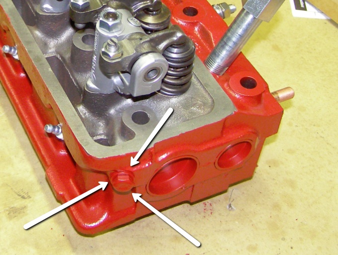

Do you have a copper gasket on the plug going into the back of the head that is right on the main oil galley? That can run right down into the bell housing.
As in where the arrows are pointing below:

well with the dye I found one leak, the oil filter adapter was leaking pretty bad, once I got it off that round/ square o ring had a gouge and tear in it, must have boogered it up when I installed it or repositioned the housing so the filter would clear the frame and not unloosened the bolt quite enough, replaced it and so far no leak there, the bolt in the head is not leaking and the valve cover gasket is fine, so I will run it and reinspect for more leaks, Might have sneaked passed the major cam plug one. but the oil pan bolt is still weeping just slightly, next oil change teflon tape will be used too

leak solved. gasket in the oil filter adapter, so this thread is CLOSED
