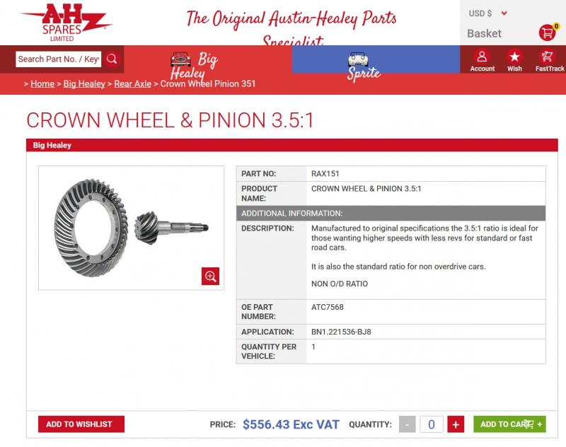

Even adding $100 for shipping, this is still a terrific deal, compared to $1049+ship from Moss. You might save on shipping if you bought it from Healey Surgeons, who import from AHSpares in bulk:

I can't believe it would be cheaper since you can get the 3.54 gears from DW for about $750 and figure maybe $3-400 to have someone install the gears in your pumpkin so it should be ready to install yourself for around $1200?
