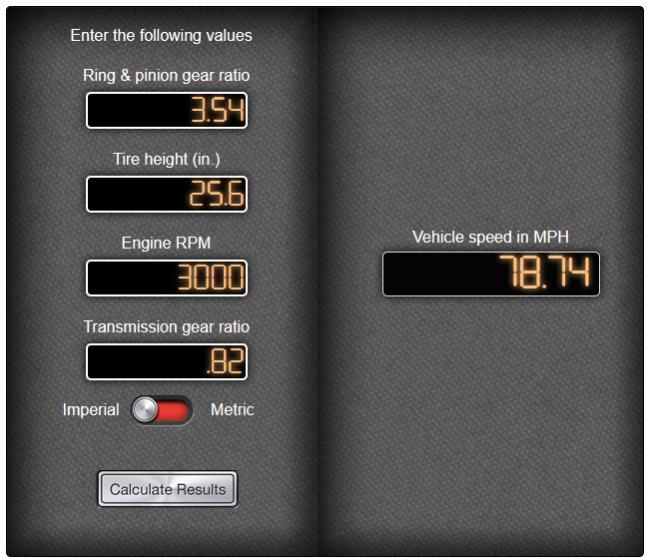

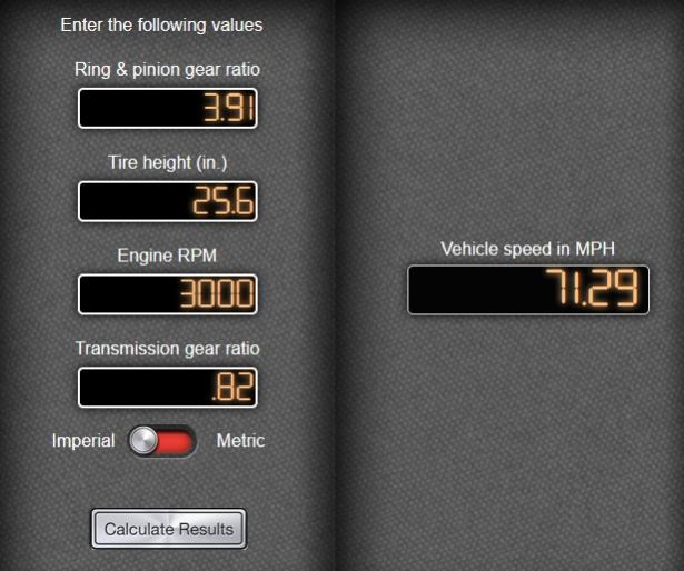

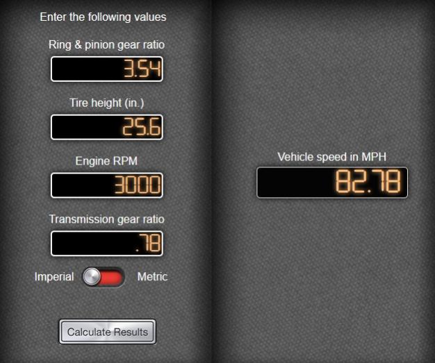

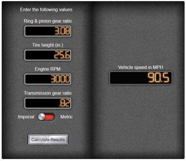

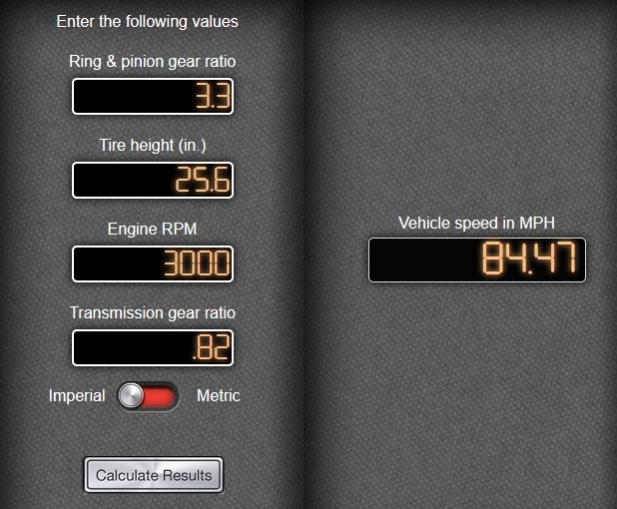

Speeds at 3000 rpm. From an online ratio calculator. .82 is 22%OD; .78 is 28%OD.
Formulas: 1-1/.78 = .28 (28%) ; 1-1/.82 = 22%
Stock BJ8
3.54 axle with 28%OD or Supra 5th
3.54 with 22% OD
3.3 axle, 22% OD
3.08 axle, 22% OD
