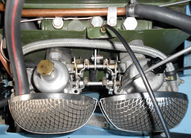

P.S. - here is what I have:

Mark,
Just saw your pictures and my oil separator hose went to the bottom of the Weber air filter just like your SUs and it was not enough vacuum. If you do develop a leak you could tee the separator into the line you have running from your valve cover to your air filter.

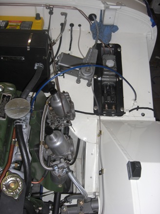

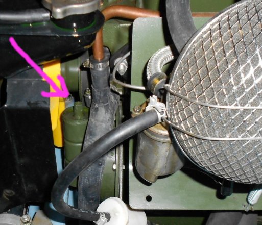

Can't believe I've never carefully looked... but it would appear that I can't install one of those Y-branches that pulls some vacuum off the carbs. These would be the "emssions" ports?
Well, unless I'm missing something, there doesn't appear to be any such access except that central plug on the intake manifold.
