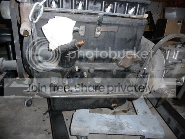

On my block you can see the metal plate blocking off the mechanical fuel pump inlet. Below and back from that is the road draft tube. Mine is turned upwards and has a hose attached to it that went to a catch can for racing. Normally, they are turned downwards towards the road, with no excess piping.
Cheers,
Tush
