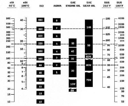

Engine oil viscosity is rated on a different system than gear oil. A 90 rated gear oil is fairly close in viscosity to a 20-50 rated engine oil.
The OD relies on clutches operating in oil to transmit power. Any oil which has friction reducers will cause the OD to slip. Any engine oil without friction reducing additives should work. Beware of "super slick" oils in the OD gear box.

Attached is a chart to compare viscosities of various engine & gear oils.

20W50 and 90W gear oil are almost the same viscosity. 90W was the original specification for both non-O/D and O/D TR gearboxes. But over the years I've personally used and seen others use 20W50 "racing oil" in non-O/D and O/D TR gearboxes without any problems.
