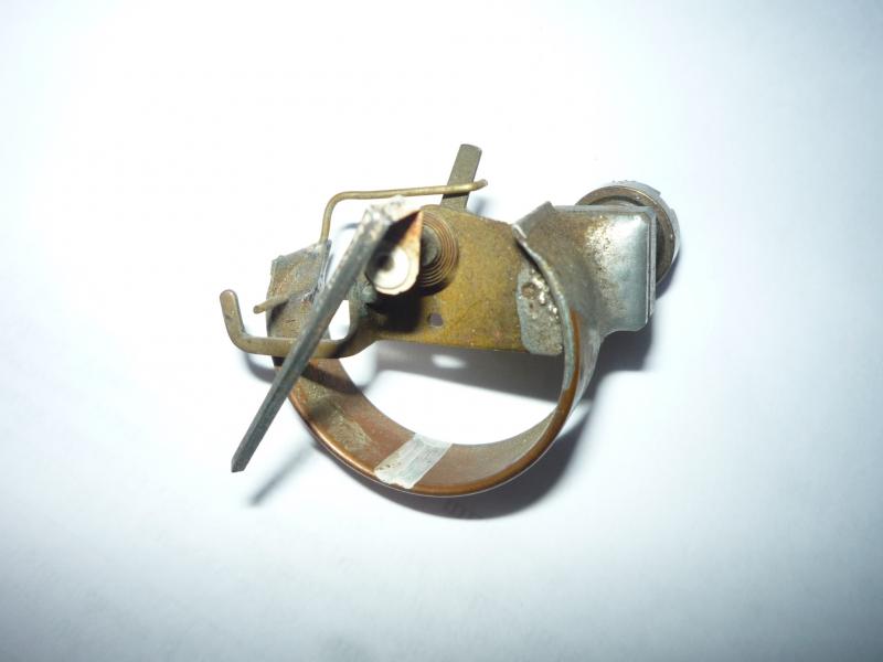

Here's what it looks like on the inside; maybe you can see what is causing the hang-up. You can alter the reading by moving where the wire acts on the arm that moves the needle. P1110317.jpg

Thanks Steve, I still have the glove box out and I will see how well I can get in there that way. Taking the big gauge out is a pain also because of steering brackets. Tropic 6-- yes the gauge is probably rubbing somewhere inside. It looks like maybe right at the top where the needle 90ies down to the face; it could be touching the face there. The fuel and temp have bout an 1/8 of open air there. Have you ever tried to calibrate one by bending the needle with the glass off and diving? I will try and fix it if I cannot find a better working gauge.
