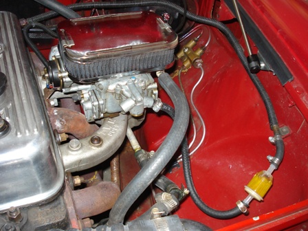

I am attaching a photo to show the carb setup. I don't have a manual for the carb, so excuse me if I sound ignorant, but shouldn't there be a pressure relief line headed out of the carb back to the tank?
Tim

OK, I think I've found the problem. After studying a schematic of the carburetor I noticed there was a small screen filter on the inlet side of the float bowl. I pulled the top of the carb off and found no gas in the bowl. That easily explains the symptoms I've experienced, so I thought "AHA!" it's the filter. I pulled the filter and find it to be clean, and all ports that carry gas to be free of clogs and debris. So, back to the drawing board. I decided to try the fuel volume flow of one pint in 30 seconds, as Dr. E suggested. Fixed up an empty quart glass jar on the end of the line and turn the ignition on and.. and... and......... no pump clicky. Fuel pump must be working intermittently, since it filled the jar a few weeks ago, but now doesn't run at all.
So, I can say I've eliminated everything down to the fuel pump. I know I reworked that pump last summer when it wasn't working, so it's probably time for a new one, or would anyone suggest something else, like a rebuild? Anyone do a price comparison on new vs. rebuilt lately?
Tim
Scott_Hower
Pumps are easy to rebuild. In fact, if someone rebuilt it and didn't set the points to "tickover" properly, it may just need some adjustment.
Been a while since I've fiddled with one, but I seem to recall you want the points to "flip" near the end of the pump stroke. Doc will chime in if I'm wrong.
