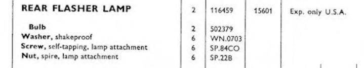

On the corner lamps (which were turn & tail on early cars; stop & tail on later cars), I believe the screws went into "spire nuts" that clipped onto the panel protruding from the rear apron. I don't recall offhand if that panel was a separate piece or part of the rear apron, but I don't recall it being screwed on. If it was a separate piece, I think it was spot welded to the apron.
The parts catalog also lists spire nuts for the later turn lamps, in spite of the apparently original nuts visible in Tom's photo.
