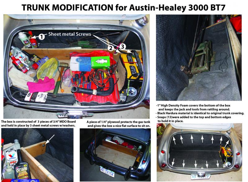

Hi Guys,
Are you sick of wasting energy dragging that lump of a spare tire around?
In the 43 years I've driven this car I've never had a flat, but I do carry a can of Fix A Flat just in case.
If I have to haul extra weight then I'd prefer it to be tools and parts.
Here's what I did to make the trunk a little more functional.

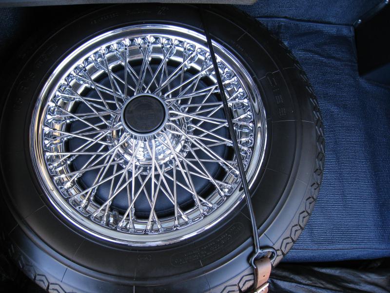

Sorry, but I was under the impression that Fix-A-Flat (or similar) was most effective and focused on a tubeless tire and not on a tube tired wire wheel. Either way, I have had a flat and was very happy I had a spare to replace. Yes, it would be nice to have more space for parts but only for a small number of critical replacements which don't require much space.
My attempt to optimize boot space has been limited to the installation of a 10" woofer inside the spare for my sound system. However, for those without a sound system, you may want to use this space to store a box with other parts. Either way, I would suggest carefully considering the elimination of a spare if you have wires with tubes.

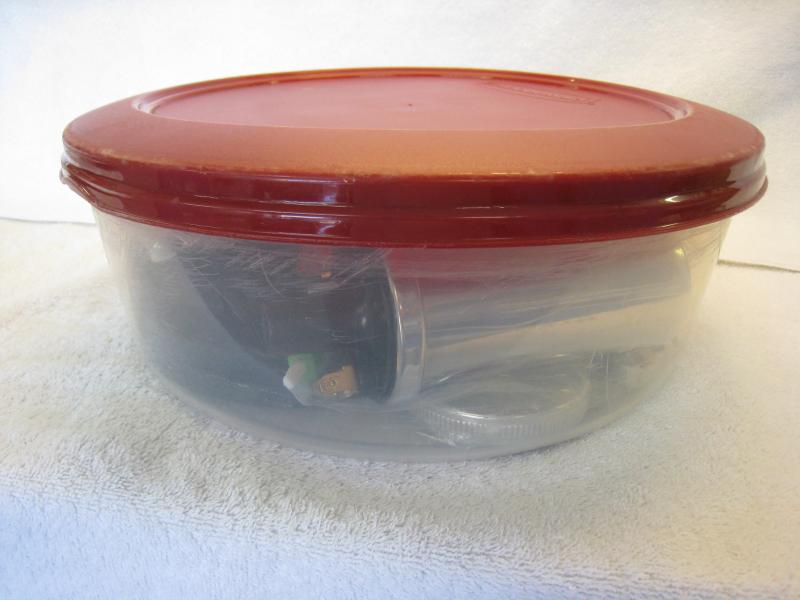

As far as where to store spare parts (the ones you'll never need) I put in a cake container that fits under the spare tire.

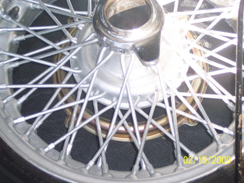

Even if you are in your home town and have a puncture WHO! are you going to get to fix it. Most shops have never seen a true spoke wheel and do not have the knowledge or facilities to repair a tubed tire.:friendly_wink:

I always new there was a reason to keep that old Fruit Cake tin, fits under the WW perfectly and keeps tools and spare parts dry with a lot of storage space.
