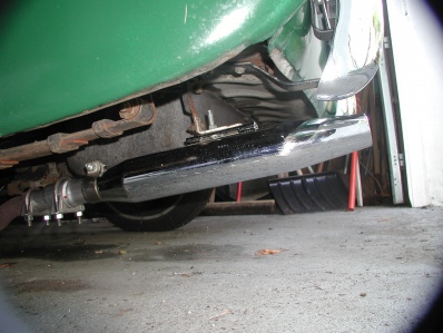

I think the style shown below will fit better with an overrider than the larger cutoff tip style.It is more bullet shaped.
Jim_Gruber
Another shot

I measured the Harley Muffler with the cut off tip and input is 1.75", This one is not tapered on the end like the one I currently have on Bugsy just tip is cut at a 45 degree angle.

I measured and the ID of the front pipe is 1.75". Just stop by and see what they've got that has been pulled off of a bike. Even if it isn't the correct size, you can get adapters to go from 1.75 to 2" and 2.5"pipe. Sometimes you need to use more than 1 adapter. Also you'll need a really big U Bolt to go around the muffer as the cut tip muffler for example don't sit straight and are designed to mount 45 degrees off of level. I'll use a big U bolt again from Autozone to go around the muffler and than attach for my flexible muffler strap.
Trev, this is not tough. Just go and see what might be available, tell them what your plans are and then go by the bog box Auto Parts store and get needed adapters to connect the pipe as well as keep the tip oriented up and down and sufficiently far back that it isn't leaving soot all over the back of your car. I know you can do the creative engineering for something like that. I'd also recommend tack welding the adapters together I found lots of flex there in just a couple of days with clamps loosening up. These mufflers aren't lightweight so if you can figure out a way to get two mounting points wit U bolts and flex straps all the better.
