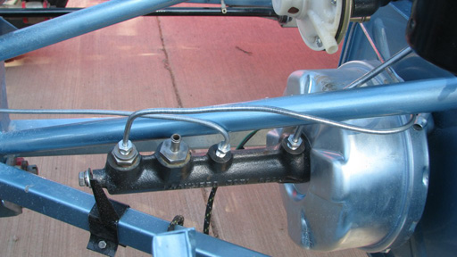

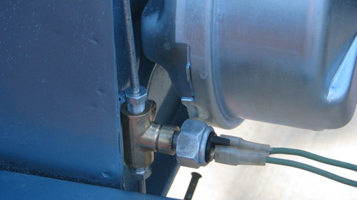

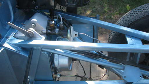

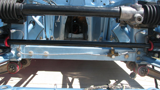

I've got the Jag outside in the sunshine today finishing up installing the brake lines! Decided to take a few pictures (attached). I still have to buy and install new brake fluid bottles (expensive) and new flex hoses (probably going to go with steel braided). After that, I'll be ready to fill & bleed the brake system!

Sunday, 5 July, 6PM. Just finished installation of all hard break lines! Woo Hoo! I'm making progress!

Did ya do the rear with the subframe in or out of the chassis?
Administrator
Boss
In - on my back. Getting the crossover (bridge) pipes screwed in on the tops of the calipers was the hardest part.
