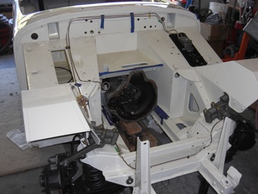

I finished stripping the engine bay on my B/E today, and removed all the steel hydraulic lines.
Doesnt look like the vendors sell preformed steel lines. Have to bend your own it looks like.

I bought all my brake and fuel lines with all the fittings from fedhillusa.com. Easy to bend. Their web site helps out with all the right fittings for our Brit cars. I purchased a tubing end former from Sears.
Scott in CA
There should be no couplings in the bugeye brake lines. Definitely no compression nut couplings.

I bought the copper-nickel alloy brake lines from Moss. My original brake lines were pretty rusty, inside and out. I think the only time I used the bending tool was making the sharp bends near the master cylinder. Everything else I did by hand, using the originals as templates. The line going across the front support to the right front wheel was the worst to reproduce.
I was replacing the master cylinder and replacing the seals in all the wheel cylinders while I was replacing the brake lines, so I switched to silicone brake fluid. No rust, no leaks, and after 5 years the fluid is still crystal clear. Also put it in the clutch system and no problems there either.
