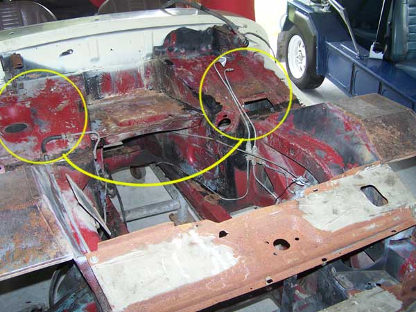

Thanks for all the advice, just one more question if I may? what is the difference between a UK master cylinder setup and a US setup????
The area where I need to reinstall the master cylinder to convert to RHD has a large circular hole closed with a rubber plug, while the US side has a rectangular area cut out.
