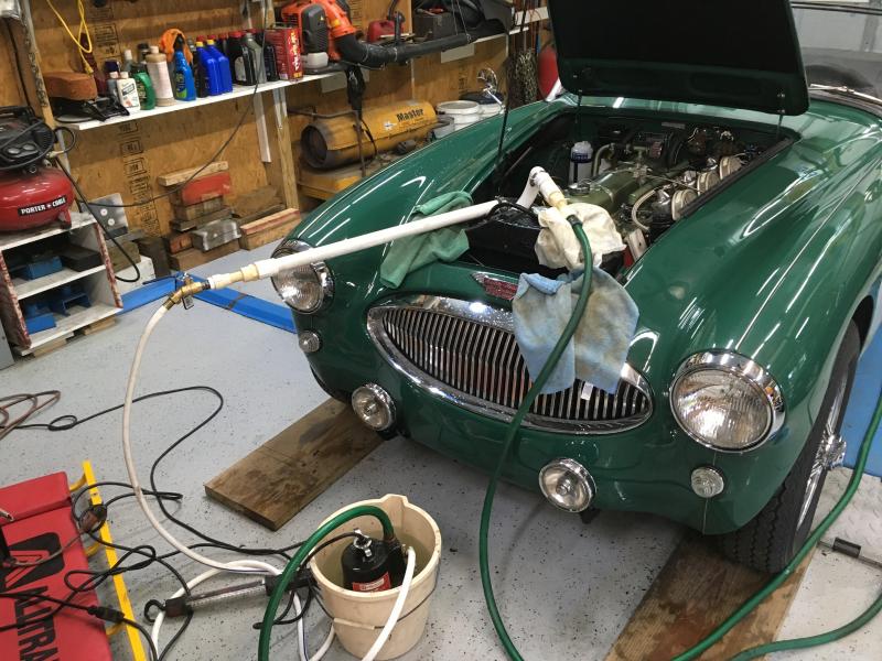

i wanted to work this fluid thru the system for a few days. instead of dumping in and using the engine, i decided to pump it thru. i removed the thermostat. then put the cover back on. nect i connected the top hose where it would go on the radiator to a pvc pipe. then clamped another hose on the top of the radiator. connected both thru pvc fittings to garden hoses. put one garden hose in the bucket and then put a sump pump in the same bucket and attached the other hose. allowed me to recirculate the fluids thru. the hose i had come back in to the bucket i ran thru a funnel with a screen on it to catch any crud. also set the sump pump up on a block of wood to keep it off the bottom of the bucket.
then when i was done i connected the top garden hose to the spigot and ran the bottom hose out in the yard. turned the water on and let it run for a while to flush out any left over cleaner. you have to be careful how much water you let run in the radiator. it can not take full house pressure.
after you flush a while, then open up the drain tap on the radiator and drain it. when i went to fill it back up, i filled the engine first thru the thermostat housing until it was up to the thermostat. then the rest of the way thru the radiator. also drilled a hole in the thermostat cap to let air thru and checked it in a pan of hot water to be sure it was opening properly.
yup all the work and got hardly any crud out of it. so i guess i did it for piece of mind.
and if you do it this way, put a valve on the return hose. even if you shut off the pump, it will still drain from the engine and run all over the floor once the bucket is full. i would come out a couple of times a day and run it for 15 minutes. did that for 3 days.

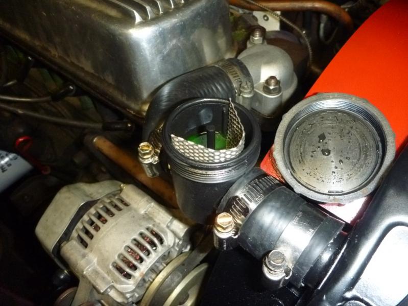

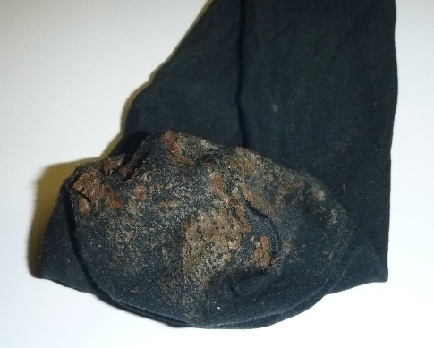

I did mine with this simple setup using a stocking for a filter:
Results - rust flakes and WaterWetter muck:
After that, for a while I ran the Tefba cooling system filer (from eBay). Removed it later when it was done trapping the few bits left after the backflush.
