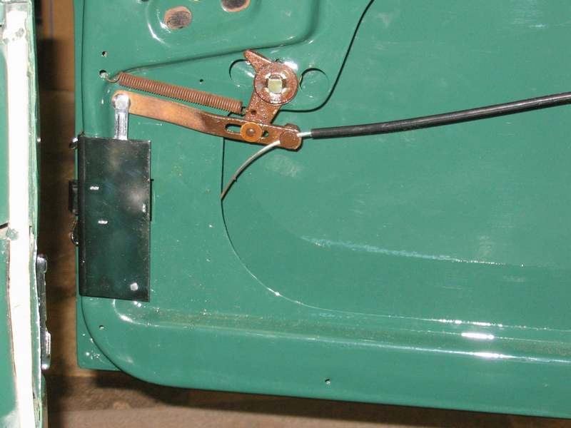

There was an excellent post a while back that shows door differences.
I just did my feeble search but could not find it.
If someone could provide a link, it may help this fellow.
Bob
Don Elliott
The original doors for a post-TS 60000 TR3A have rounded corners at the bottom. Also see how the door lock, handle and latch are assembled so the handle does not droop.
My early TR3A (1958) has square bottom corners.
Don Elliott, Original (early) TR3A owner
