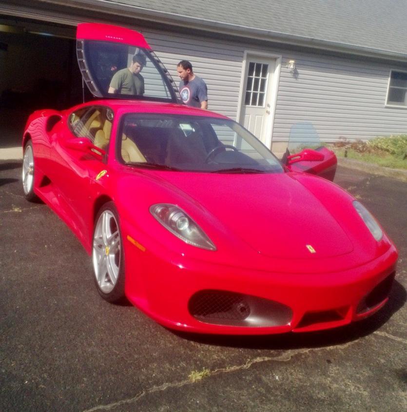

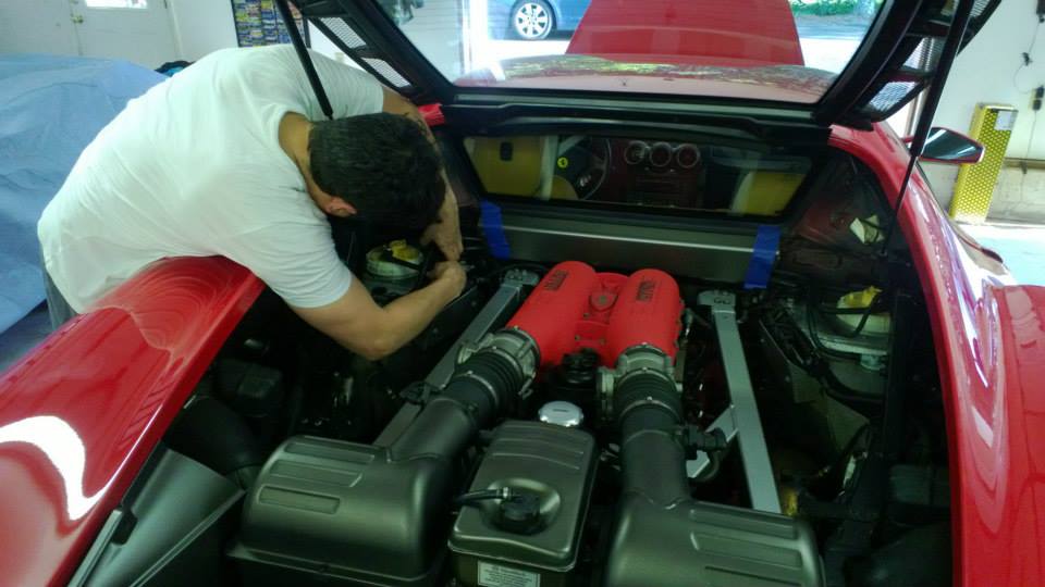

thanks guys!! You guys are the bomb!! I spent half the day replacing fuel pumps in a ferrari F430 that my buddy owns. He insisted we coudl do it so i said, it's your $300K car, I am not insured..let's do it! then replaced the potentiator (which lived behind the gas pedal buried in the footing. he stripped the socket for the screw so I set him up so it would work. he thinks I am a genius. I laugh and told him without the guys on BCF that I would be screwed!! let me tell you changing those fuels pumps is NO easy task! The access to them is so limited yuo got to get it dead or you are hosed! On top of that they are about 6" wide and are about 2' long...and they have to sit perfectly in each of the tanks. Long story short. we did it and I am now officially have had a Ferrari in my garage, worked on with my tools and succeeded. My kids think I am incredible to have a Ferrari coem by! lol

here's some pics...
