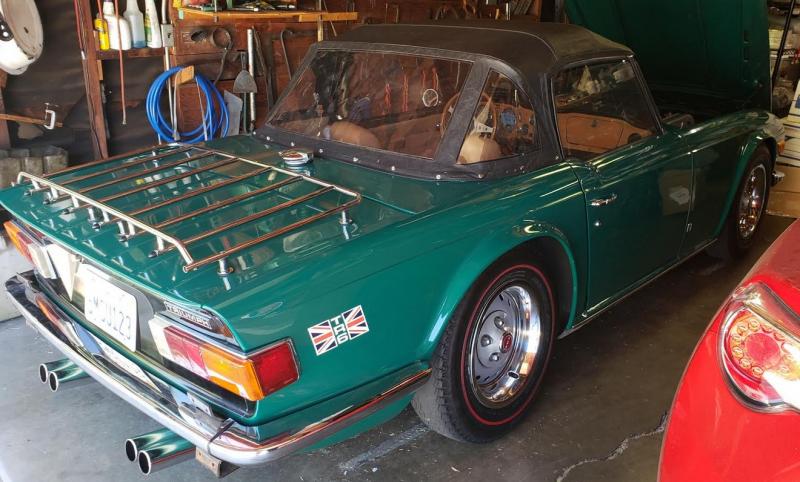

I'm the new owner of a '74 TR6. I live in California and my car doesn't have to be smogged. So am looking for guidance about setting it up as if it were 10 years older. For instance, what does one do with the retard distributor? Can it be made normal?
Has anyone written a book or a paper on some of the easy things to do.
I have a decent budget, but first want to make the car run properly before getting inside the engine.
I'm a 20 year Healey owner and active on the Healey Forum.

OK, but I just got the car last Friday and it's in the shop replacing the starter and a bad rear u-joint.
Will reply later on after I've had a chance to fix some things and put some miles on it. Gonna be apples-to-oranges, I think.
The TR6 is certainly going to be more comfortable with a better ride. Healey a good deal faster - we'll see what can be done to pep up the '74 TR6s low-compression engine.
More later.

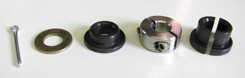

PS - I ordered the Good Parts throttle rod bushing set which looks to be super-easy to install compared to the stock setup:

Good call on the throttle rod bushing, I don't call uncle on many things, but after spending the better part of a day and slicing them down to the point they were almost worthless I gave up and rigged up my own setup.
