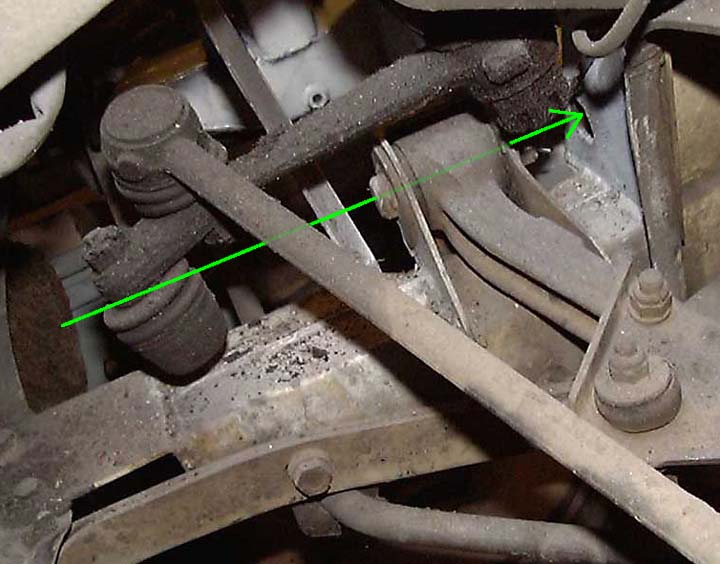

Man, it has been like 83 years since I did that last on my Healey. I'm assuming you've used a fair amount of penetrating oil. For the first one on each side, I may have resorted to a claw hammer, keeping the nut on the bolt. But I honestly don't remember that part. The second bolts, I used the holes in the shock tower. You can put a long rod through the first A arm bush hole all the way to the other bolt. That gives you more room to use a hammer in a productive direction.

With the spring removed I have been able to jack up the front suspension and get a steel bar 1" X 1/2" between the end of the bolt and the shock tower. Yes you need a big hammer at this point.
If you are installing new bolts then it's alright to hit on the end of the old bolt. Otherwise back the nut off (which is about a couple of turns) till it is flush with the thread of the bolt so you hit the bolt and nut at the same time.

As Greg says it easy to remove the rear one, thru the holes left by removing the front one, unfortunately the front one can be the problem. If the usual penetrating fluid and pry bar dont work, there are 2 other tricks.
First being to burn the rubber out, second being to find a short bolt and nut, then with a piece of metal plate fit the bolt end to end with the front bolt and sandwich the plate against the chassis upright (the plate over the hole that Greg shows in his pic) what you are trying to do is use the short bolt to expand between the upright/plate and the suspension bolt so that as you undo the nut on the short bolt it pushes the suspension bolt out. You may find that if you put as much pressure on it by undoing it as much as you can, you will find the next morning it has popped out on its own.
