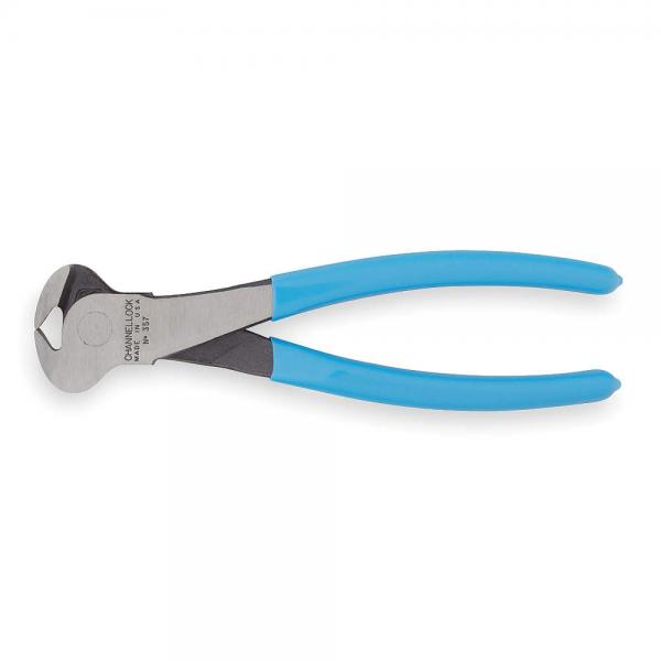

I have used this type of cutters to remove very stubborn keys.

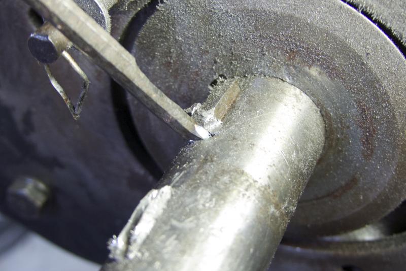

these are tough
moved the rear one with modified chisel until the tip broke off
front is immobile . as you can see, if I get the photo uploaded, I have cut into it but still no daylight at the edge.
might have to get a home visit as I cannot see carting it off to a shop at this point

Looks as though the front key needs some desperate measures.
I hesitate to suggest it but you may be able to drill a 3mm hole in the center of the key to weaken it. The key cutout is 5.4mm deep at the center of its arc. I have never had to do this but it works with bolts that won't move.
On the rear key as the chisel has not worked have you tried gripping the key with large SHARP side cutters then raising the handles so that the tips of the cutters lever the key out of the slot?

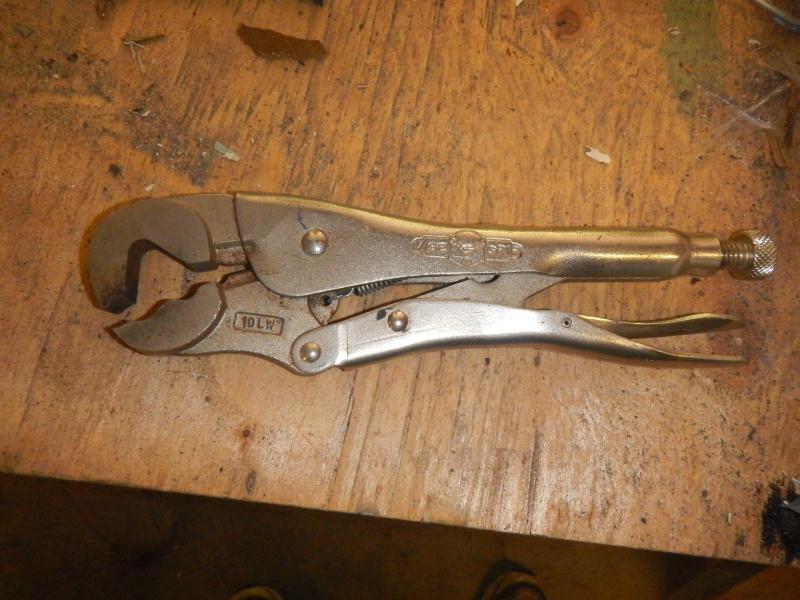

Another tool that can be used to grip keys. It is great for getting a real tight hold on nuts and shafts with out marring them.
David

Doc, I'm rarely at a loss for ideas...but I'm not sure where to go from where you are. The front key has nothing left to work with, and the rear is not far behind. All I can add at this point is to use great caution with the crank slots. If they get buggared there is no fix, meaning the need for a new crank.
TR3driver
Great Pumpkin - R.I.P
Hard to say for sure, but it looks to me like you didn't go deep and wide enough with the Dremel. Ideally, you want just a paper-thin section left between the cut and the crank, all along the curve of the key. From there, it should be easy to use a small chisel to collapse the key sideways, even if it was glued in with Loctite.
In operation, all of the force is on the sides of the key & slot. A thin groove along the bottom (if you cut too deep with the Dremel) won't hurt anything at all as long as you don't touch the sides.
I don't see how it would happen (TIA perhaps?) but if you do bugger the slot beyond use; any crankshaft repair shop should be able to weld it up and recut the slot for you. Out there on the nose, there won't be any concern about the heat weakening the crank. Of course, that still involves pulling the engine and so on, but it can be done.

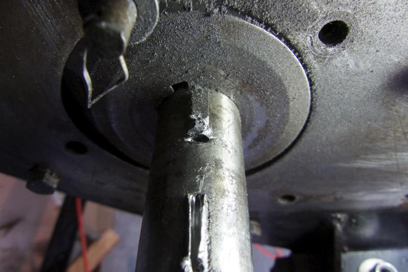

still very unmoved, even though I have got an opening at other front of the second key I cannot persuade it out. so yes, they may both be glued in. I cannot see any of the edges of the front key, and worry about cutting into the shaft.Hoe much further can I cut?
I shall try heat tomorrow and maybe a few incantations. 2 photos:

try photos again! having spent (another) sleepless night, I am left serriedly wondering
:1/ Did PO weld the keys in as he welded in the liners to the block ( not very well). 2/ whether I should quit altogether> Cossting a lot of money which is running out.
heat should not budge Loctitye which PO had used on the Dynamo nut, for which I also had to seek help!

Doc, I really feel for you. I have never seen a key in as tight as the front, even after removing that much metal. It does appear to be much more than simple locktite, although I don't know how it could be welded, unless the PO hit it with a spot welder. I don't put anything past the realm of PO's.
A decently equipped machine shop could cut the keys out easily, but the crank will have to be removed to do that. Also, if you damage the crank, I do have another you are welcome to for shipping...so the logical course at this point is to keep going, getting more aggressive until either they come out, or the crank gets damaged.
On the front key, it looks like you can use a punch to tap the sides inward, relieving some its grip in the crank. It also looks like there is enough of the side of the key left to grab with a small set of vice grips, and then tap on the pliers in the upward direction. After that, my only thought is more careful grinding until the key is paper thin on all sides, and then use a gasket scraper to remove it.
I wish you luck...like I said, worst case I've got a crank for you if the job goes awry.

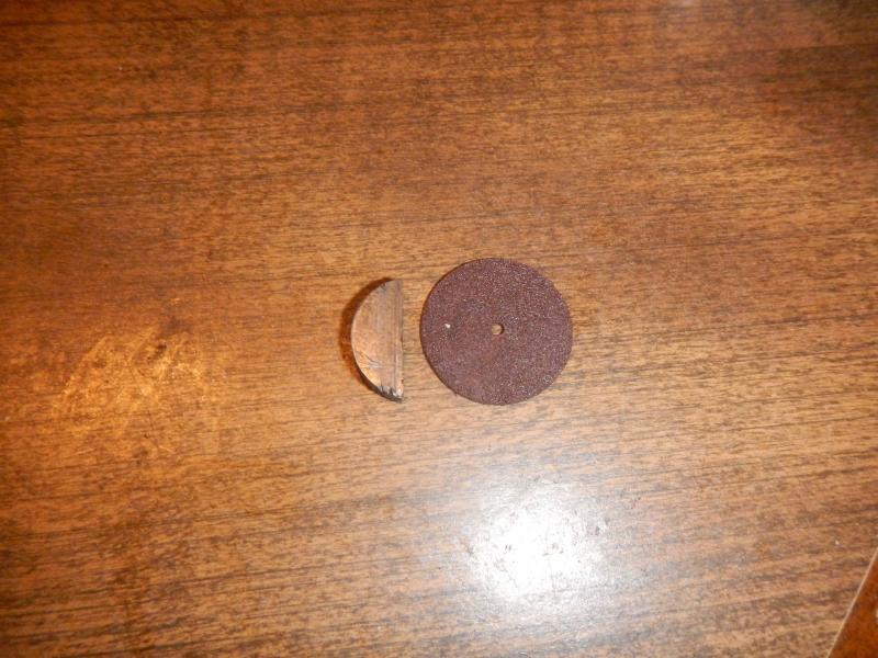

As you can see from the photo the key is almost the same diameter as the Dremel cutting wheel so you could cut all the way to the bottom of the key with out damaging the shaft. At that point the key should collapse if you hit it on the sides.
Good luck
