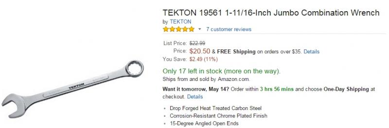

The 1-11/16" combination wrench is available on Amazon for $20.50.

I had the same problem on my 100, I was working with a breaker bar with a cheater pipe attached for even more leverage, I ended up bending the professional grade bar (SK tools if I recall right) and then snapping off the half inch drive on it. An impact wrench got me nowhere. I eventually bought a big old combination wrench, and a few hits with a wire wheel hammer and it came off. The breaker bar actually had quite a bit of flex when you really pushed it, the combination wrench, with the broader cross section did not, I think some of the old manual even refer to such items as a striking wrench or something like that to be used in just such situations. Worst stuck nut story I have, struggled with it for days off and on.

I have ordered a 1-11/16" combination wrench, which I plan to use as a striking wrench and/or use the starter trick with. The wrench is not here yet. At this point I am not planning on raising the engine because I plan to build a small fixture to lock the harmonic balancer in place (as some members have suggested). Should be able to get the wrench on the nut easily enough.
Plan B is the impact wrench, in which case I guess I will have to raise the engine and make a new fixture set up.
