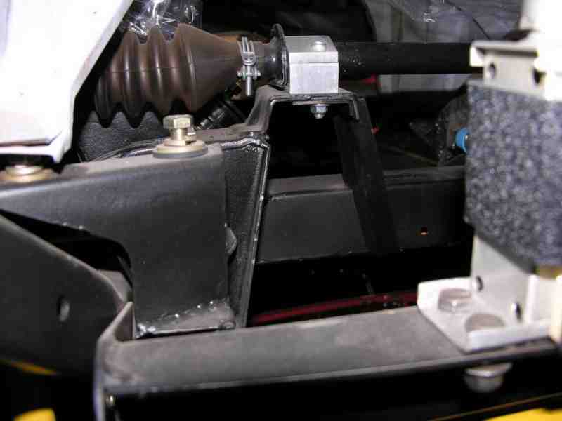

I had a hard time fitting poly bushings using the original mounting. They seemed too big and wouldn't compress enough to get the mounts right. So I gave up and replaced them with Goodparts aluminum. This is on my project so I haven't driven it yet.
