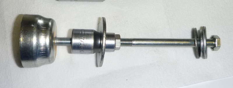

I made this installer with a 5/16" fine-thread coupler and bolt:
