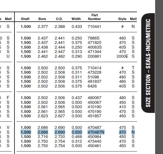

The seal's OD is 2.690 inches, and the opening at the front of the differential, where it has to fit, is 2.620. The old, original seal that I removed was 2.625 OD, which makes sense. I can't see any way this new one will go in, but maybe there is. If so, could someone enlighten me? What have you guys used?
I did a little research, and found that the seal no. 470487N is the one listed everywhere for the TR4, and I also found the dimensions in a Timken catalog (below). The TRF seal has those dimensions. It appears that the 451857 should fit; it's nitrile instead of polyacrylate, and there are small differences in the style of the seal. I don't think those differences are significant, so lacking any other suggestions, I think I'll get one of those.

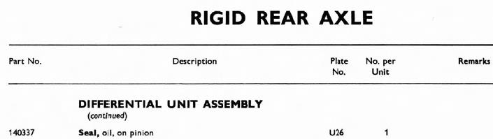

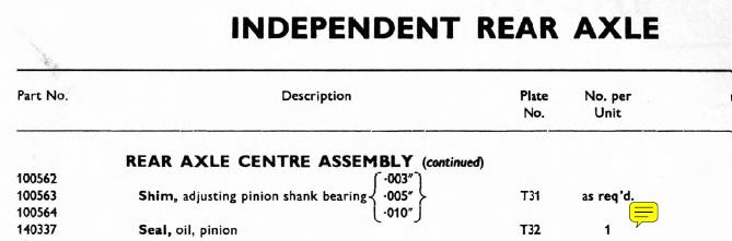

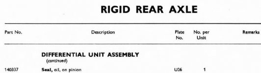

Just for grins, here are the listings from the factory SPC (2nd edition in both cases). First TR4A, then TR4

Hmmmm....the plot thickens.
In a 50-year-old car, anything is possible, but I don't see any indication that the axle has been replaced. The crud layer on it was much the same as the rest of the car, and all the bits, like the mounts and handbrake-cable supports, are like a 4A. Finally, this car appears to have been left alone and neglected for decades. I can't imagine someone who doesn't even care much about basic maintenance changing out a rear axle.
I received the seal from TRF yesterday, and it clearly would fit, but it's not the 451857. It is the one they sell for TR4s; their part no. is 100898. My best guess is that there is an error in the parts manual, and TRF and others used that info to stock their parts.
