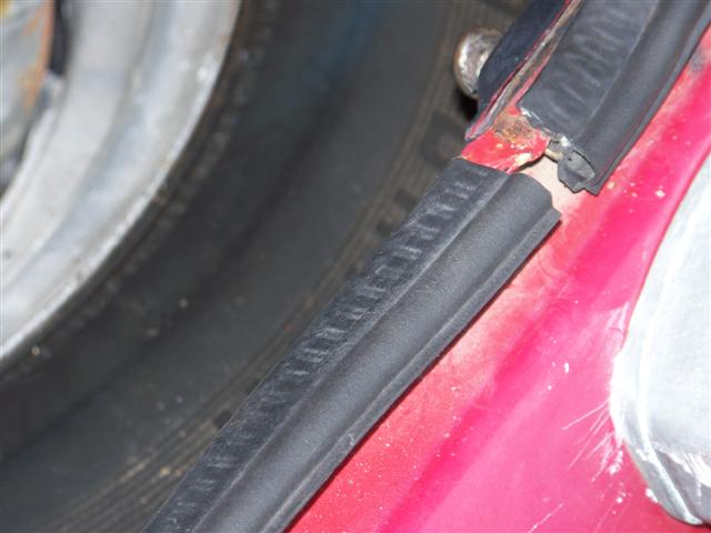

My trunk lid sits higher then the body. This can not be correct. Not sure we have the correct seal.

The seal

To me, and remember I have no trunk on a Bugeye it looks like the seal is not worn in yet.
Will it push down correctly or even fit correctly without the seal?

I have played with hinges and moved the trunk lid from side to side and back and forth. If I remove the rubber seal I can get a better fit.
