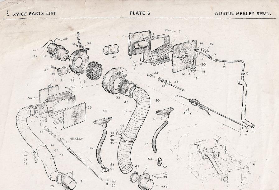

pics (I Hope)
bug_sixty
For those in some way impaired.....Ok... fresh air unit on left and heater on right....Also, for those who have most but not all the OEM BE stuff...look at this.... refer to #15 on the heater hose.... observe that there is a plate above the hose....this plate I have seen once on the nearest OEM sprite I have ever seen back at the 25th conclave in Aspen.....The plate was a caution plate that warned that the area or hose (I can't remember exactly) was very HOT..... when that hose needed replacement the plate and the old hose went to the trash bin....
