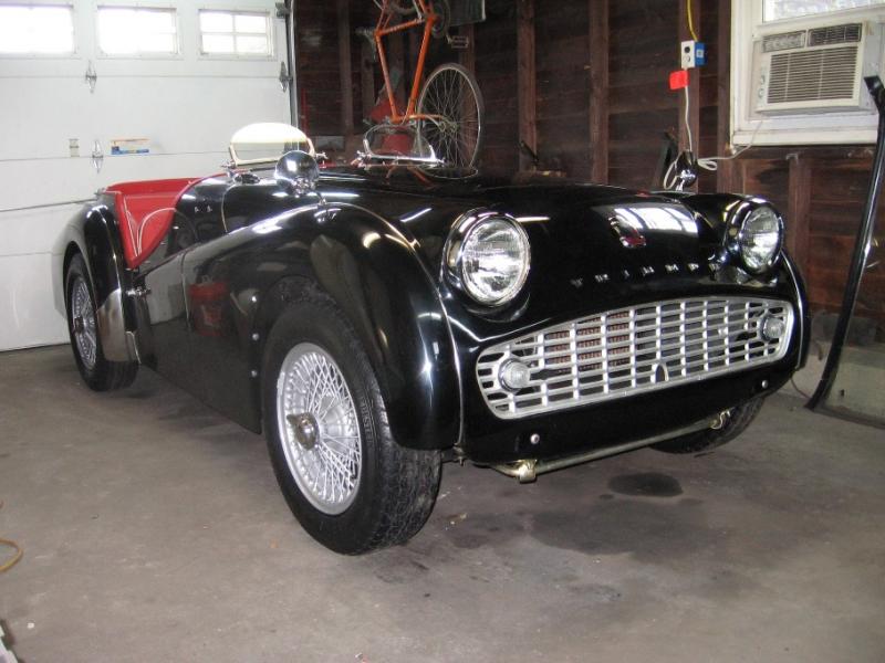

I have been working on the Apron basically removing the old putty, paint and rust. I hammered and dolly pushed and poked out the dents until everything is within about a 1/8 of being flat/smooth. I bolted the apron to the inner fenders and outer fenders to make sure stuff fits, plus refit the grill a couple of times. The grill goes in but fits tight and looks better than many, but not perfect. My fear is the tightness, and when painted, pushing the grill in will damage the paint and the damage will show. I could put inward bow on the grill and that should help. Part of me wants to open the grill hole up more by some hydraulic means, but that outward protruding lip around the grill looks challenging and weakly supported on the ends. That is why I bolted the apron in on the fenders, inner and outer, so that the grill might open and leave the rest of the shape be intact providing maybe and 1/16 of an inch for wiggle room. I guess if I did something like that I would need some kind of strong arc to push the opening evenly up or maybe it would be better that the bottom straight part went down. Moreover, the grill mounting holes on the bottom want the grill to push in past that little finish edge of the grill.

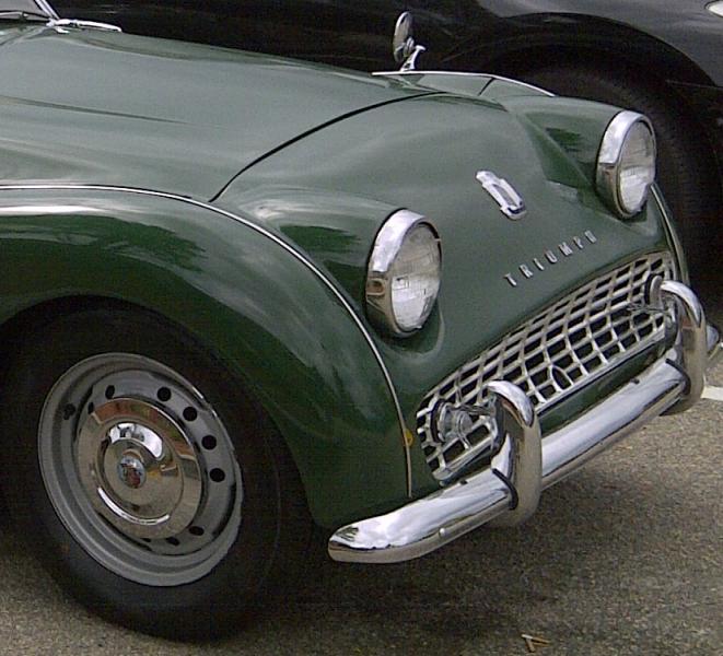

I went to the British show in Belleview, Wa, and there were all these tr3 large mouths side by side. I noticed that some of them had much bigger lips than others, so I am actually not sure what an original nose looks like. I do have the original grill with this car and the damage was not too bad. What it showed to me was a lot of lip that kinda bulge out.
