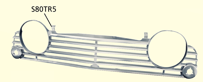

I'm curious if they did install TR4A grille's in the earlier ones. Was it painted properly for a TR250?
Here's the picture from Bastuck's website:

The grill on my 250 wasn't painted like it should for a 250. And there was some previous body damage that led me to believe that it was in a accident many years ago. The one I have is pitted and the corrosion is on all bars. I have tried to do some clean up on the grill. It would take a lot of hours to make it presentable. But it will still be a 4A grill on a 250.
