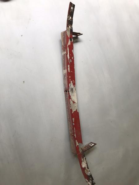

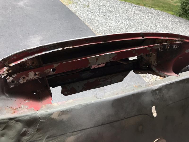

I removed this piece from inside the grill surround. It was bolted on with 10/24 bolts about 1 inch long with square nuts. That makes me think it was either added at some time or was removed and replaced. It’s made of aluminum. I can’t find it in any of the catalogs either. It has two 3/8 th inch holes that look to have had something bolted in them. Maybe lights behind the grill. It also has bondo filling two other holes. The bonnet was originally baby blue and there is no sign of that color on the piece.
I’d like to know if it even belongs there before I make a new piece.

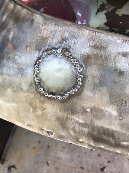

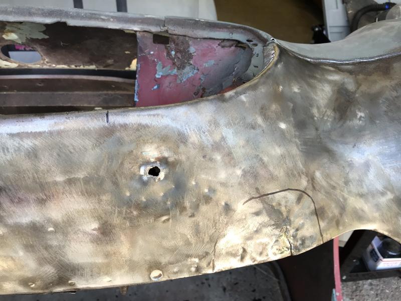

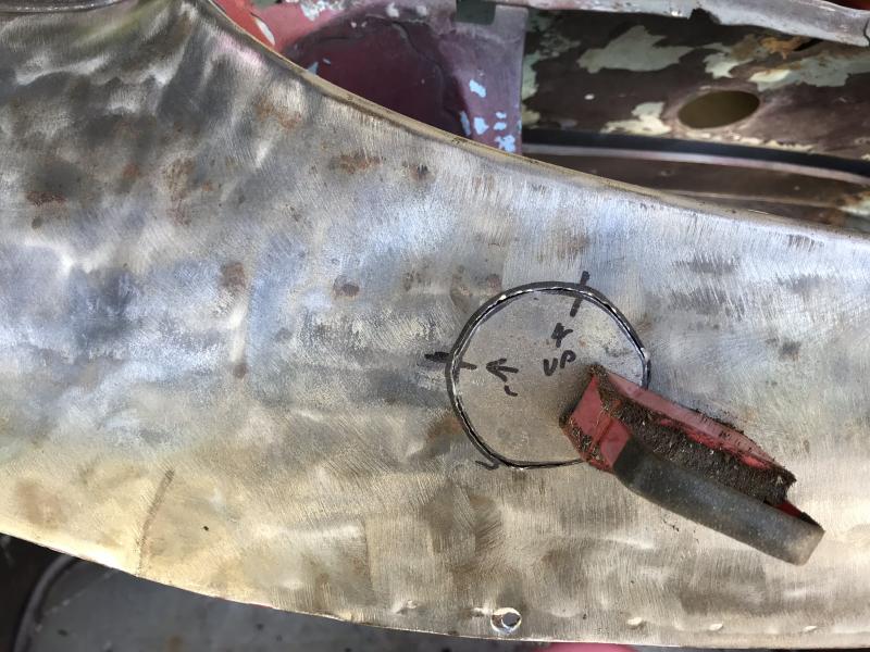

Thanks Rick, there were also two holes in the valance that looks like could have been for driving lights too. Both of them were recessed like they had been hit. As with most bonnets it looks like it has been hit a few times. All the damage was hammered out and 1/8 to 1/4 inch of bondo used to make it look good. I will hand it to whoever did it. It looked really good. Rather than just patch the holes I cut out the damage and put new metal in. EF97991D-D316-4319-8799-FAF55E7D74E6.jpgE7DB556A-9E71-4561-9BF6-6DF89B702FEE.jpgAE529DE5-1488-4F7F-A6B1-290CAE14E5C8.jpg

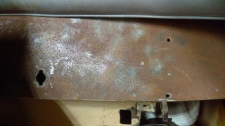

Gerard
The small-ish holes in the lower valance are where some small screws (10-32, if I remember correctly) would have originally existed for the license plate plinth would have mounted. I am referring to the wide plinth made to fit the wide UK plates. Remember that the bumper was optional, so the plinth would be used if there wasn't a front bumper. These were seldom seen or used in the states.
