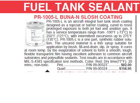

Dick: I am assuming that you have already restorred the tank? If not, it should be cleaned thoroughly and then the inside should be treated with a good quality sloshing sealer. The sealer bonds with anything loose and prevents those small particles of crude from getting in your fuel.

New tank Frank, wonder if I should do that even if it's new?

There were some very unhappy people a few years (decades?) back, when it was discovered that the "sloshing sealer" being sold then would not stand up to reformulated gasoline. The problems caused by it peeling off the inside of the tank made the cure much worse than the disease!
So I've always just relied on the original sediment bowl and filter screen to remove any rust flakes. The original tank in my 3A did shed rust slowly, but it never caused a problem for me.

Lou: where does one find a synthetic horse? :devilgrin:
angelfj1
