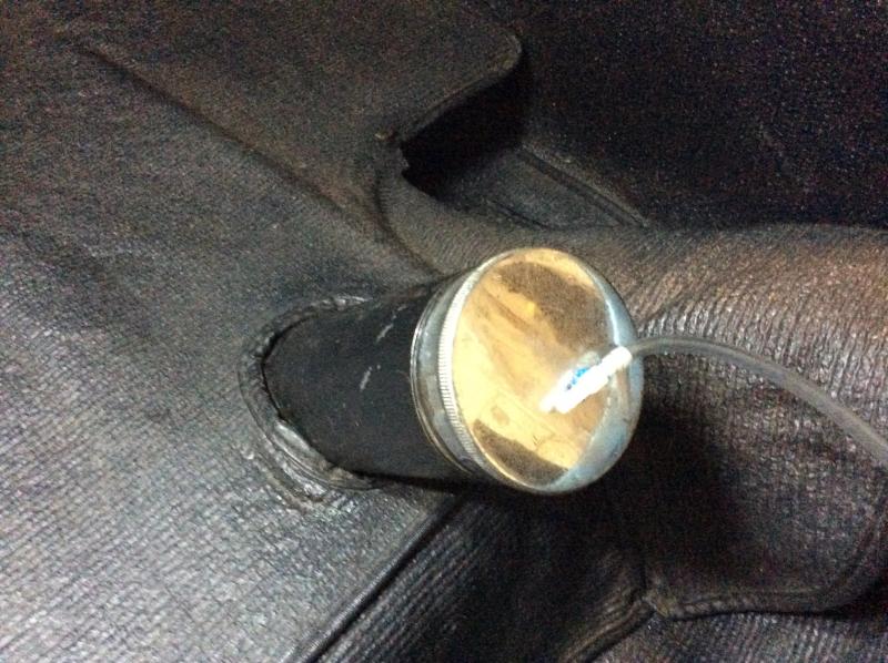

Has anyone tried to fix some kind of hose nipple onto the face of the cap so that the tank could be vented to the exterior rather than into the boot?

A member of our local AH club made such a modification and I made a rather crude copy, to test if it works. I’ll take a photo tomorrow and try to post it.

Thanks for the reply and I look forward to seeing both a pic and report of effectiveness.
30114D79-A963-49C3-90A4-433F55A57DFA.jpgIt looks like someone beat me to it! I did say mine was crude! The fitting is a T piece which I think is used for fish tanks and the tube is routed into the open. I drilled the breather hole on a spare cap, big enough to accept the plastic fitting. I have not used this cap while driving because I fear the tube may get blocked with foreign matter from the road or water which could be sucked in as the tank empties. If the car is parked for any length of time it is hoped that petrol fumes will escape and not fill the boot (sorry “trunk”!) space!

View attachment 57065It looks like someone beat me to it! I did say mine was crude! The fitting is a T piece which I think is used for fish tanks and the tube is routed into the open. I drilled the breather hole on a spare cap, big enough to accept the plastic fitting. I have not used this cap while driving because I fear the tube may get blocked with foreign matter from the road or water which could be sucked in as the tank empties. If the car is parked for any length of time it is hoped that petrol fumes will escape and not fill the boot (sorry “trunk”!) space!

Charlie Hart's solution was to run the tube out through the bumper bracket opening.
