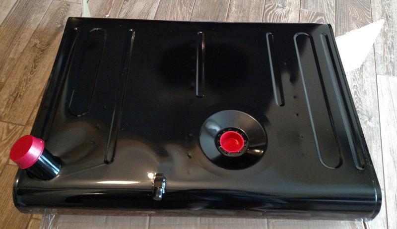

I received the Moss tank yesterday and it appears to be good quality. I did a quick measurement of the two tank's fuel outlets and there is only about a 1/4" difference between the old & new. How much difference are there between the longbridge and the later models? Curious if i'm replacing the original tank or not.

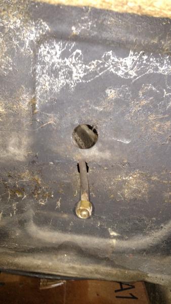

The difference is about 1.25 inches and it's primarily vertical. I had to weld my old hole shut and drill a new one.
After pulling back the trunk liner further it revealed the original hole.
