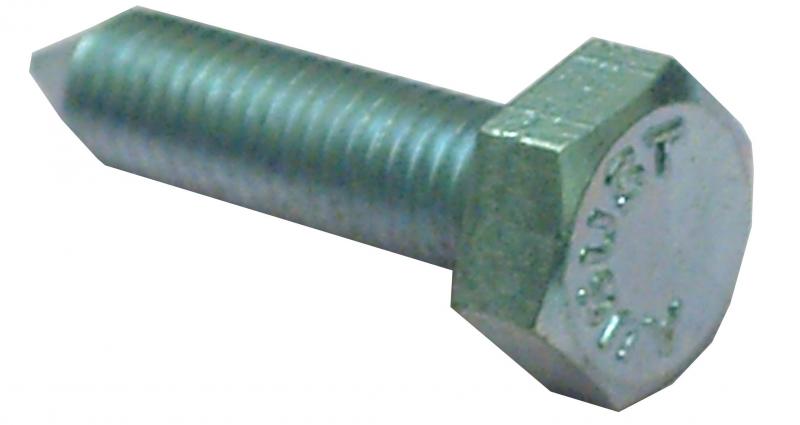

Also, are the bolts pointed? If not, get some; they make the job a LOT easier.

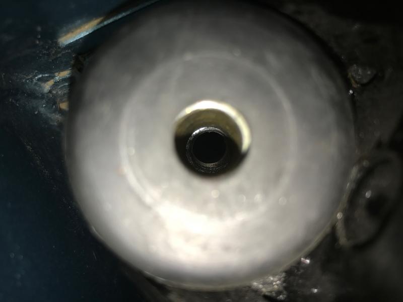

Yep they are pointed. I bought them from XKS specific for this purpose. I may have to pull the tank out again and make sure the mounting bracket is completely straight else I'm trying to fit a straight bolt with fine threads into a mounting nut with the threads slightly askew. That's what I'm staring to think "may" be the issue. Because of shete this mount is locate, in the left-rear corner of the boot, I can't look down into the grommet.spacer tube, but I did manage to get my iPhone camera situated over the mount to take a picture. As you can see, the threads down their are signed up with the tube, but look like they "may" me slightly off alignment. Hard to tell for sure as it could just be how the cameras was situated.
I've (reluctantly) decided to pull the tank back out and check the alignment of the mounting nut on the left-rear mount. I'm thinking it is slightly askew, thus preventing the fine thread of the bolt from starting.
