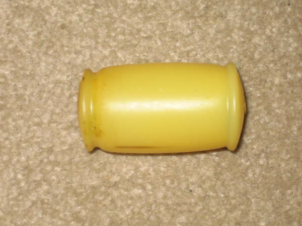

They don't sell replacement floats for Minis either. Could you measure the float you bought (or the cracked one) and tell me the OD, length, and the diameter of the gland where it clips onto the float arm? Thanks.

Doug, Sorry I didnt see this sooner, I just looked back up the post as I did the exchange on the float last night. Here are the dimensions and a picture that will hopefully help you. L= 2 1/8" OD= 4" and the OD where the float attaches to the gland is just a hair smaller than 4". It kind of looks similar to the head of a coat hanger. It just clips into place on the left end of the float in the picture. I think if you look at the picture it will all make sense. Let me know if you need any further help. /ubbthreads/images/graemlins/cheers.gif

Looking at the attachment, if the length is 2 1/8", I can't see how the OD (Outside Diameter) can be 4". Are you sure you don't mean that CIRCUMFERENCE is 4"??

Good catch Art. You are right. The OD is 1 3/16".
dklawson
Thanks Brent. I'm trying to come up with alternate floats for sending units used in cars like my Mini and GT6. This float seems to be a little bit longer than that used on the Mini but basically the same dimensions as that used on a friend's Triumph 2000. It also sounds very close in size to the brass Ford floats posted a while back in the Healey Forum on this board. Perhaps Smiths standardized on a common plastic float size in the mid-1960s. That would be great news as both your float and the Ford one might be replacements for our old sinkers. As you pointed out, these replacements are a lot less expensive than a new sending unit.
