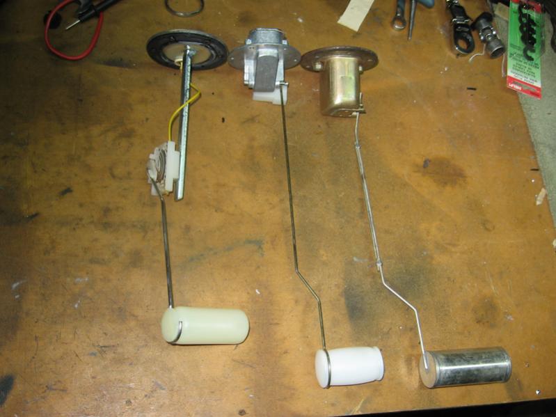

Yeah, I got stung by the Moss unit, but that was about 6-7 years ago, so many they got it right now. Anyway, I got one from ebay, but the vendor that I got it from (noslocaters) doesn't show for the TR3 at the moment. I did have trouble with the the plastic float getting a hole in it from the sharp edge of the wire that wraps around it, but the vendor did send me another float. I also bought a brass one as a back-up that comes from a Ford sending unit and fits perfectly.

Here's a picture of the different units...left to right Moss, Ebay (from noslocaters), Original

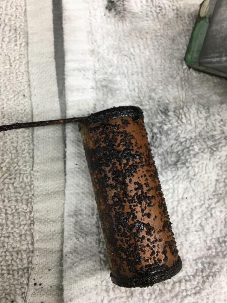

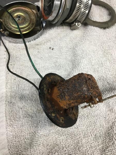

I attached a photo of the current unit...not pretty! That's what happens after sitting for so long.

When you receive the Moss unit, compare it to the pic I posted above...the Moss unit is on the left. If it has the arm swinging from the middle, it will not indicate fuel contents properly because of that.
