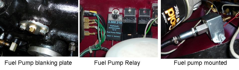

I finally got my new pump installed. I ended up mounting it on the front left inner wheel well. The location works well for wiring and for the associated plumbing. I did try to mount it in the boot as BobbyD had suggested but with the dual exhaust the fuel line just ran to close to the exhaust pipe.
I have the pump wired to a fuel pump relay from a VW... it senses the rotation of the dizzy and stops the pump if the dizzy is not spinning.
Next up will be an inertia switch...
