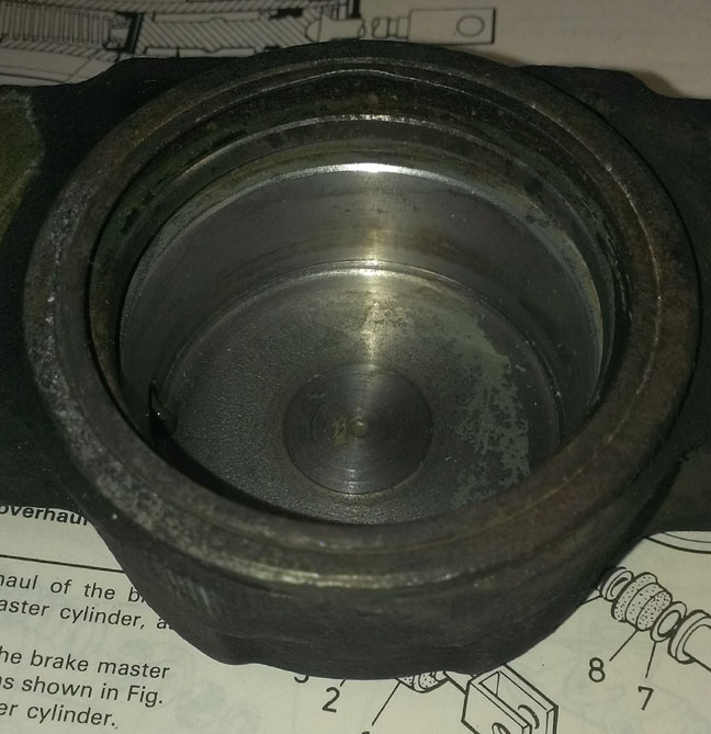

Ha! Good one, KG. Thanks for the warning. I've taken one apart this afternoon. Doesn't look too bad. There was a bit of tarnish/crud but that came of with Bon Ami.

OK, here's a good one.
The repair kit for one caliper contains 4 large O-rings and 2 steel rings. For each half of the caliper, one O-ring fits in a groove and the other O-ring fits inside the steel ring, which then fits in the top groove. Now then, half of these O-rings are fatter than the other half!
I think the DPO blundered and put the fat O-ring in the steel ring.
Who is right?
Who is right?
The square profile goes in the groove in the bore, the o-ring that has a sort of v-groove in it goes in the steel ring with the v-groove toward the piston. It acts as a wiper. From you description, it sounds like you have two the same on each side, instead of one of each.

Wow! Thanks for posting, Gerard. I never even noticed the v-grooves, and so I would have put them in wrong. Surprise, surprise.
