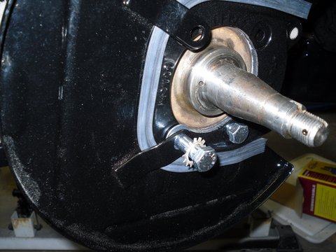

I'm installing the front brakes and hub on my BJ7. I don't have the hardware that goes with the adapter plate that the brake caliper and dust shield mount on. I have many pics but none that show how that dust shield mounts. My shop manuals aren't much help on this one.
I'm mostly Ok with the back two tabs of the dust sheild, as I have the caliper mount bolts.
Are there rubber bushings for the dust shield tab holes, both front and back?
For the front tabs; First the adapter mounts, then a washer, then the dust shield tab on top of that? A pic would help.
Thanks, Dale

I have a set of disc brakes that came with the car and I disassembled and cleaned them up. There is a flat washer under the dust shield tabs that fills the spot-face on the bracket, then on top of the tab is a star washer, the smaller bolts have external teeth on the star washer and the bigger bolts have internal teeth.

If I understand you correctly the attached pic shows the proper install. It's strange that the hole in the tab is so much larger. The tab will clamp down I suppose.
I'm not clear on star washers, internal external. Is that the way that the teeth are facing?
Dale

Hi Dale,
No trouble.
Yes, the star washer teeth I'm referring to. Really depends on how much originality you are into I guess.
