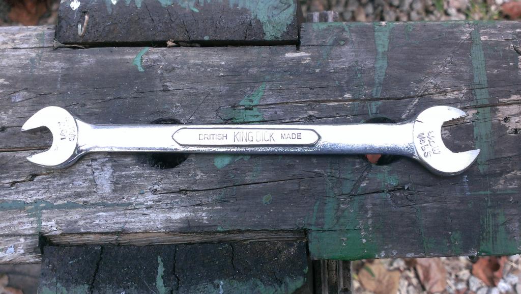

Kinda wondered why they used something as obscure as 9/32". Then it struck me - are the back bleeders Whitworth? I have one somewhere that I'll have to dig out.

Found my Whitworth - too big, but for the name alone, I'll give it two snaps up.

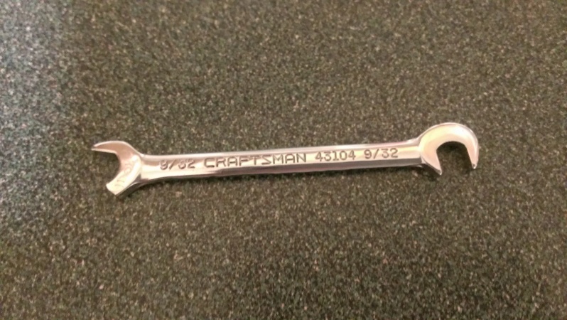

Can any kind soul take a look at a back bleeder and confirm it is either a Whitworth or a 9/32" ? Don't want to order a wrench and find it is the wrong size.
I use a 1/4" on mine (not a thin ignition wrench, but an honest 1/4").
Thanks for that info, Trev.
Boy, that is strange. On mine 1/4" is too small, in fact I've just filed a crappy 1/4" wrench to fit (I don't think it will stand up to the job because I had to file off quite a bit, thus weakening the jaws, but I'll give it a shot.) Maybe the DPO* used vice grips and chewed 'em up. I'll just order up some new bleeders, along with the brake shoes, etc.

I had 10mm bleeders on one car once -- obviously a replacement by the PO at some point. If the 9/32" works, use it.
Yeah, but I bust it tightening the bleeder (see the photo). And it's the only one I've got. (I checked the metric possibility but 7mm is too small and 8mm is too big.)
I've sent Moss Motors an email asking what size wrench their replacement bleeders take. Will report back.
