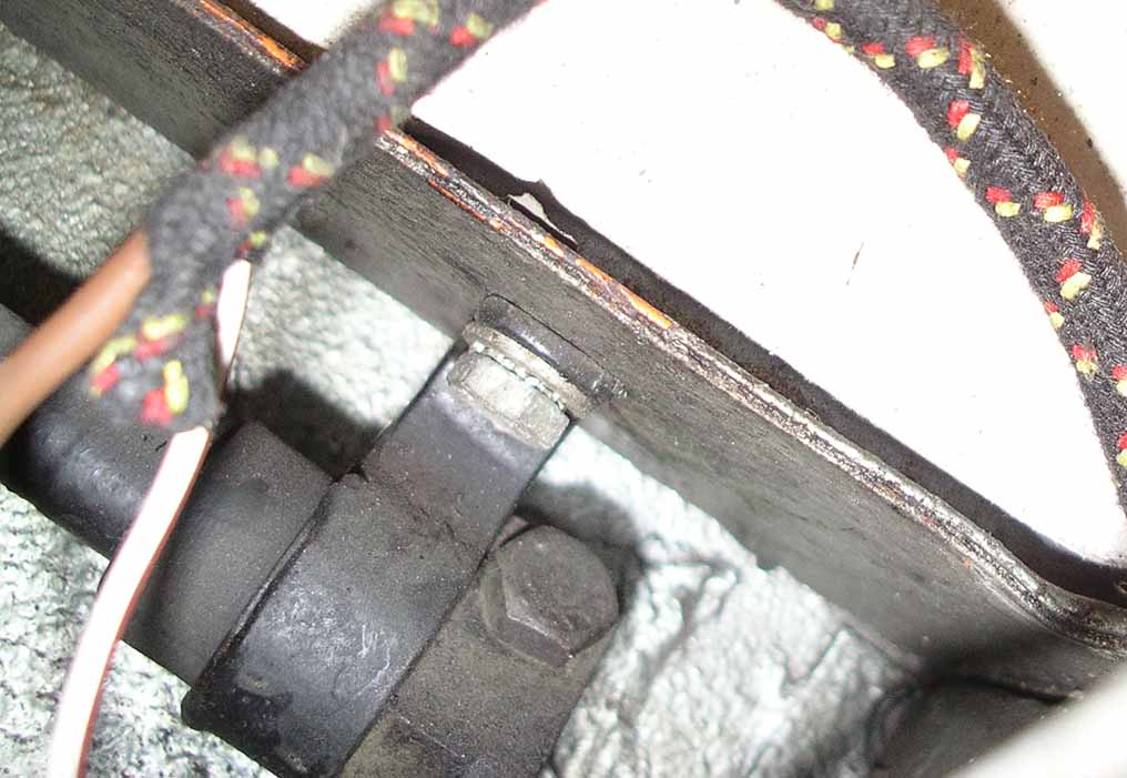

Hard to get in to look in my right hooker BJ8 so I took the attached photograph. If this is the bolt you mean it holds the cross shaft brackets for the accelerator linkage

I think Steve has it right. In the same location on the right side of the engine compartment is the windshield washer bottle bracket, held in place by two machine screws. I would bet that on right hand drive BJ8's the windshield washer bottle bracket is attached over those holes on the left side.
