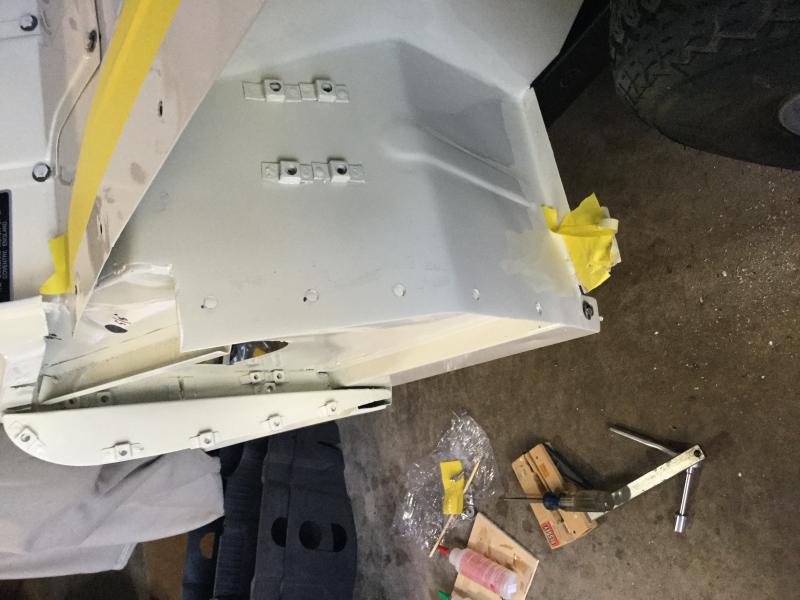

I’m installing the wing splash guards. Any idea of the purpose of the four captive nuts on the pax side footwell? I don’t recall anything coming off, and my pre-disassembly photos don’t reveal it. And curiously, they do appear on drawings... maybe it will become obvious further down the road, so I apologize in advance!
3F86DE79-3275-4286-AD6B-3BCD0934264B.jpg FBD88B92-9292-44C9-AD57-AD95328443D3.jpg

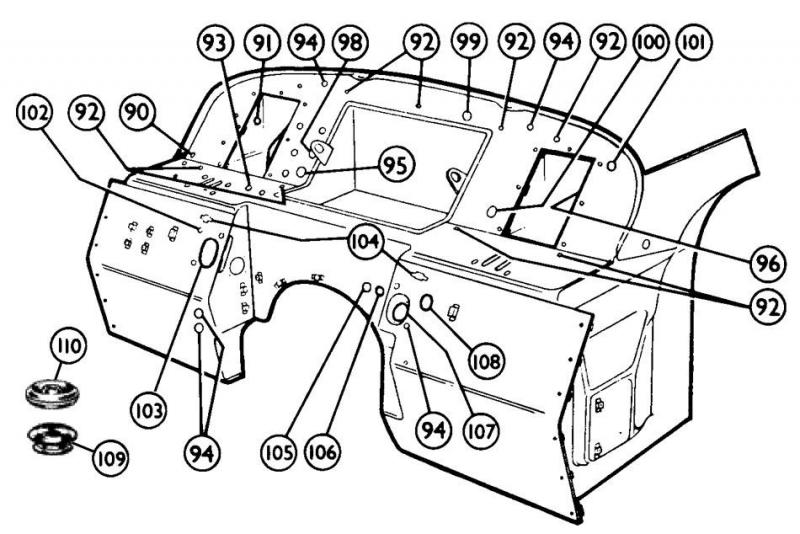

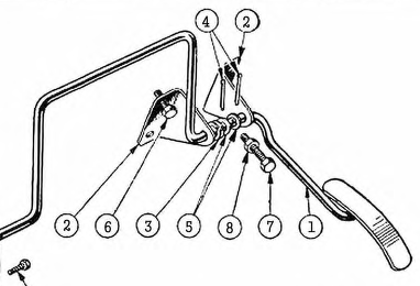

I think those are for the accelerator pedal brackets for RHD cars (no. 2 on the drawing below).
