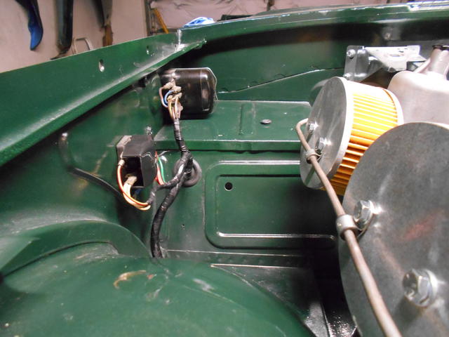

Wouldn;t two of those holes be for the body number plate? I'm pretty sure mine is in that area (albeit RH drive) - longish plate with 5 digits stamped on it (eg 12917) and riveted to the firewall in that area.

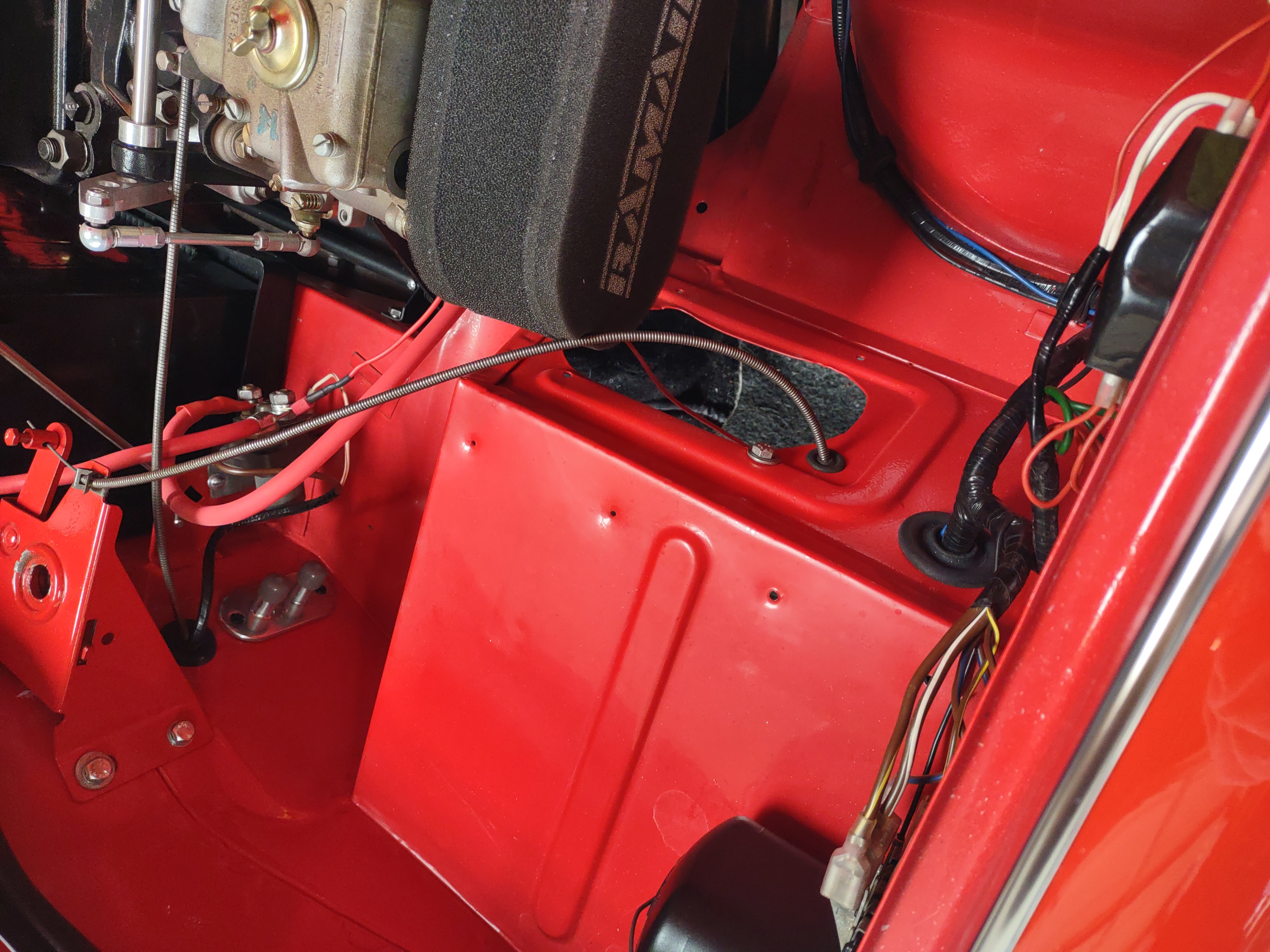

Ed - take a look at this, from another TR4A. Looks like that's not usually cut out - maybe for an optional accessory?
Yes the two holes on the top flat are for the number plate which is off while restoring the car. The hole I am referring to is the approximately 4" x 6" hole on front of the firewall. I'm sorry I posted the picture kind of at a funny angle.
But surely the big hole you mention is for the clutch/brake levers to protrude on a RHD car, linking up to the master cylinders which would mount on the horizontal platform of the firewall. Either someone previously took the blanking plate off for some reason or possibly yours has been converted from RHD - although why they wouldn't carry the blanking plate across is not clear?
Edit: Whoops - apologies, the brake/clutch levers emerge through the horizontal platform of the firewall directly to the master cylinders I've just looked at my (RHD) 1962 TR4 in Australia - it's got exactly the same blanking panel that NutmegCT posted! Bit of a mystery then!

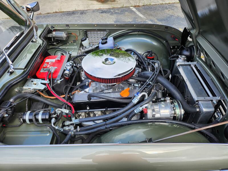

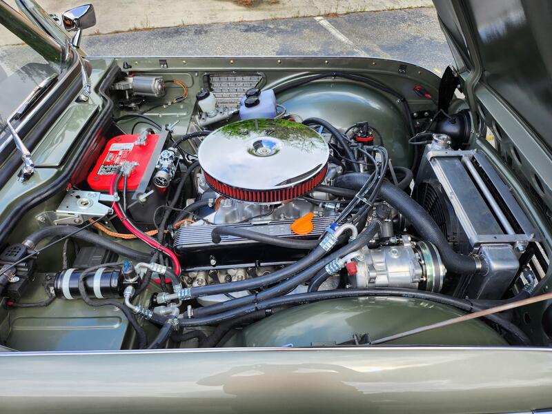

a-HA! Looks like a/c used that space for refrigerant hoses..
Bingo! It is a AZ car... There is no other remnants of an AC system but that sure could be it.
Thanks! I still have to wedge in that V8... Just kidding! :ROFLMAO:
